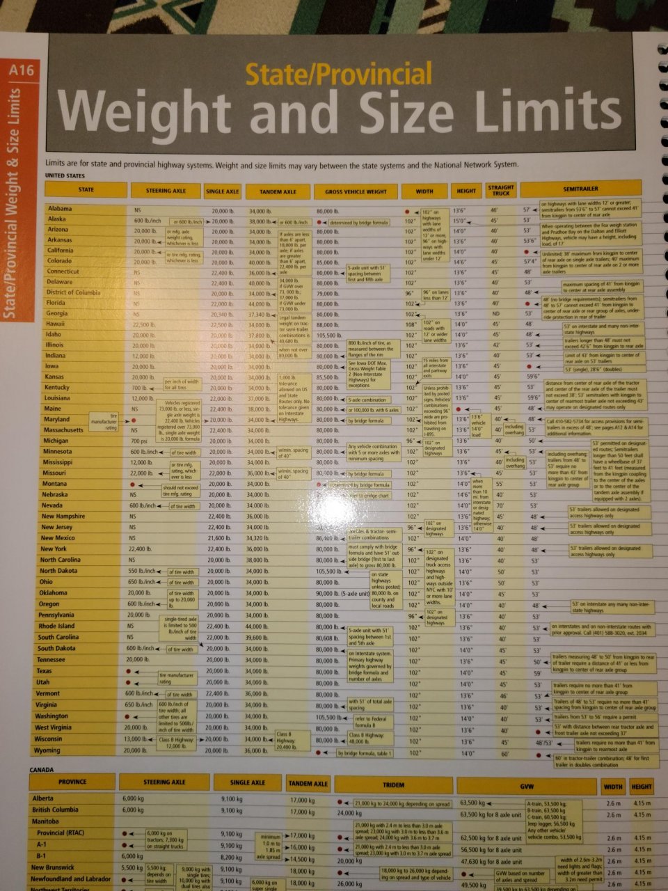

    In the front pages of the Rand McNally Motor Carrier's Atlas they have a great bunch of resources, including a guide that shows maximum length by state. I took a snap shot of my 2022 atlas page, hopefully you can read it. That said, they only identify two states that the overall length includes overhang and I know there are more that limit or prohibit overhang for divisible loads such as cars, so you still will need to look up each state you plan to operate within.
