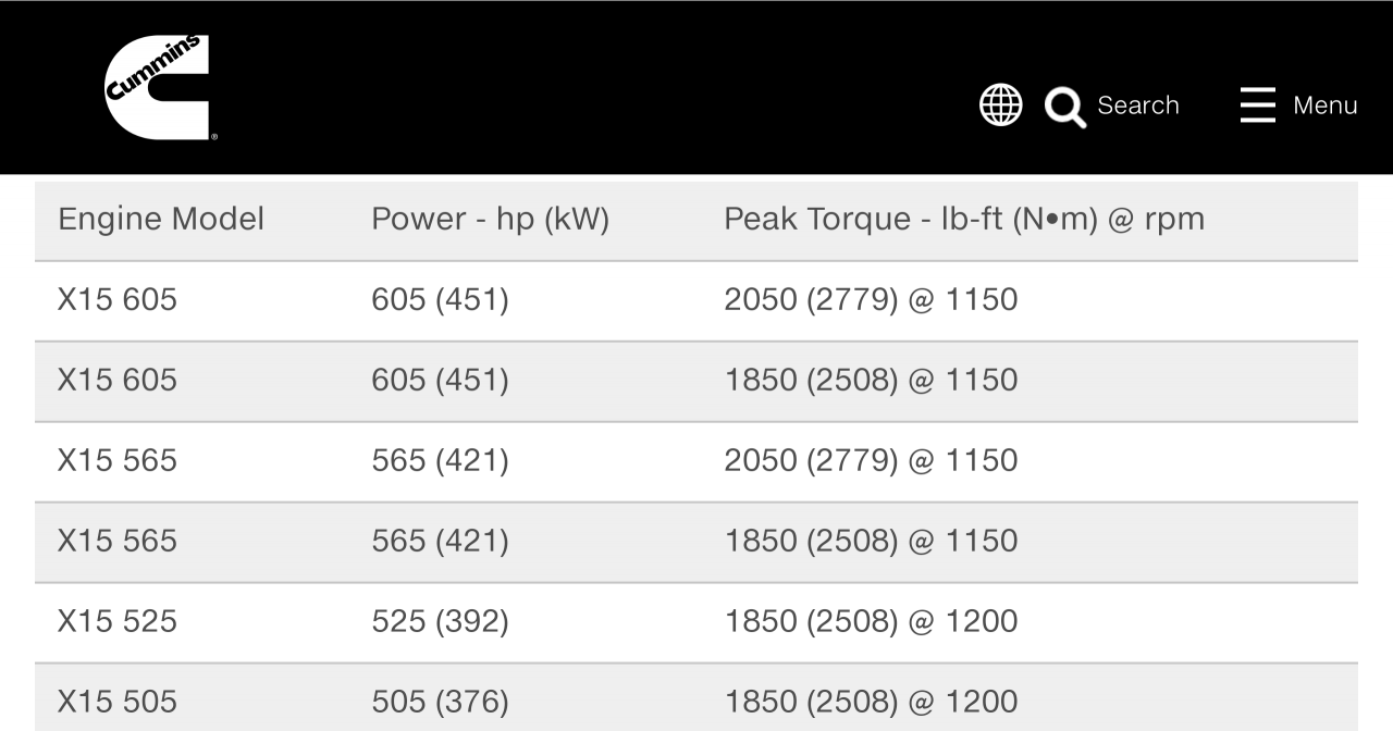

    Not always true, sometimes there are 2 torque ratings with the same hp
