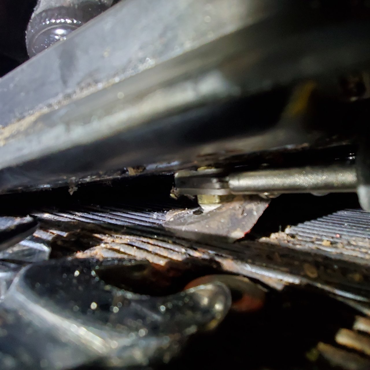

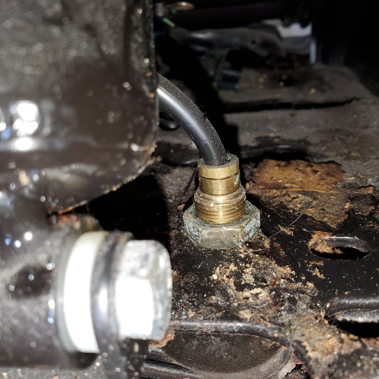

    I am trying to swap out the driver's seat on my T660 that is broken. Everything is unplugged and unbolted but this big brass fitting from the floorboard keeps the seat from coming out. I was going to try to unscrew it but the top air connector keeps moving also. Can't seem to get a wrench on the top side since the seat shock absorber is there. Any ideas?

    The quick connect air fitting should be easy, push the top in/down and the air line should pull out. If it has never been disconnected you may have to coax the fitting to release.

    I had to do that. I ended up getting a 19mm wrench around the top one to loosen that hexagon and it came free. Thanks for the reply!

    Would happen to know the name of the valve coming through the floor board mine is leaking and I need to replace it
