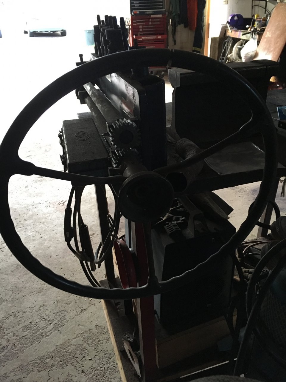

  9. Jazz1
    Jazz1 Road Train Member
    2,373
    4,971
    May 7, 2012
    Thunder Bay On
    image.jpg Buy a steering wheel puller. You will need it again someday
