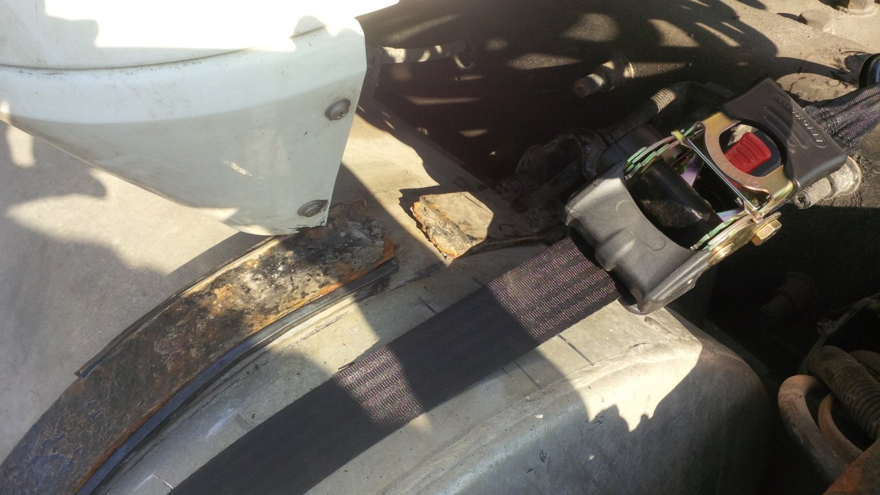

    I thought I'd share a close call I had today. We never give it a second thought, step on and off, put hundreds of lbs of fuel in them. They hold up on the worst of roads. I was about 80 miles away from home base upon arrival of my last stop for the day. The entrance is beaten from the spring thaw. I went into a big rounded pothole at a slow speed and heard a sharp clang. I wondered what it was but dismissed it for the moment. After backing into a dock I stepped out and nearly fell right off the truck. the step was mush for 3 inches. It didn't take long to figure out the minor rusted strap actually broke in the upper section. I left the truck there and got a ride from another driver to a hardware store and put a ratchet strap on to make it home.
    I'm really thankful it happened when and where it did. Tanks were 1/4 full, I travel the 401 hwy. daily which is also one of the busiest highways in the world. God only knows what could have happened if the tanks were full. Would one strap hold up a full tank on a bumpy road at 60MPH? Who knows. It just could have been worse, way worse. I take great care of my truck but never gave the straps a second thought.
    The worst part of this? $635 PER STRAP! at the INTL. dealer. I located aftermarket stainless straps and ordered 4. I'm not chancing the others.
    Be safe out there.

    Not saying one could see the failure point in your instance, but that is part of the pre-trip, checking those straps for integrity. Glad you were not hurt or injured.
    Hopefully, others will learn from your experience.

    The problem is they rust from the inside out. What ever is used between the strap and tank will hold moisture. I just dismantled a truck with two tanks, they were steel and one tank had rusted through under the strap and the other the strap was significantly rusted under the paint. I always prefer tank setups with a bracket under them carrying the weight but is something not considered when my boss buys a truck.

    There is a reason they make stainless straps.

    Yup international is bad for those. People either make their own or order aftermarket. You will likely have a bunch of corrosion on the tanks too keep that in mind.
