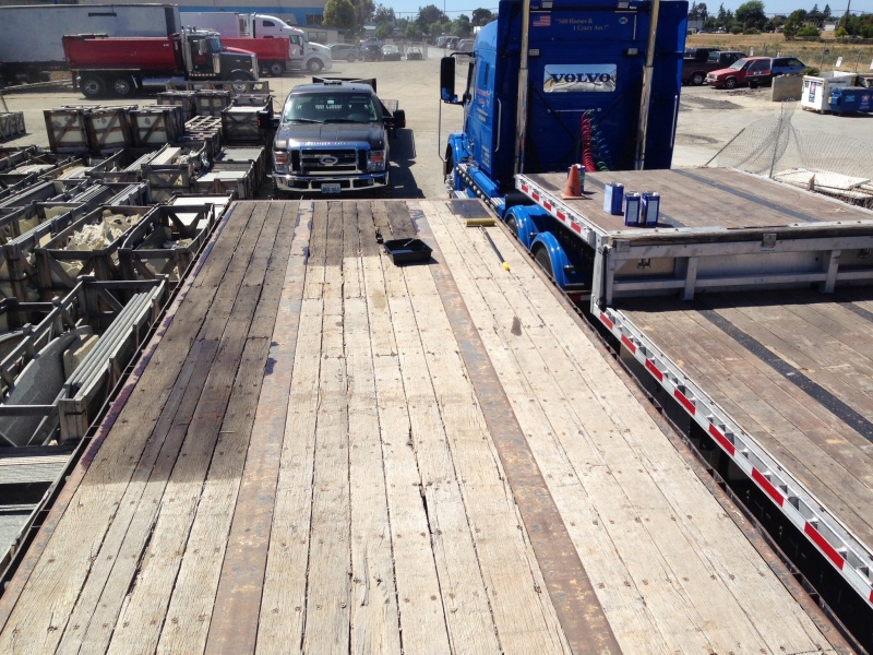

    I need to treat a couple of trailers and was wondering what's the best treatment?
    Some trailers have apatong decks, some oak and some pine.
    Iv heard boiled linseed oil is supposed to be good on most types of wood decks but can take a long time to dry in, while leaving a sticky surface.
    Has anyone mixed linseed with varnish or thinners etc to get a good result? Is there a top pick for a varnish any of you really like?

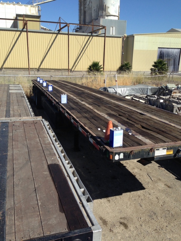

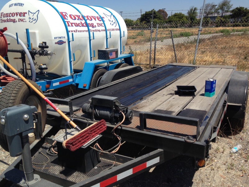

    Ok, so got a few trailers coated in straight Boiled Linseed Oil today, didn't mix it with anything as the wood was so dry but the freshest apatong deck I have I'm a little hesitant to just put Boiled Linseed Oil even mixed on it. Reason being, the BLO will soften the wood which might be bad as the Apatong being so hard is one of its best attributes. Maybe the Olympic varnish might be better? One bad thing about the BLO is it doesn't give any protection to UV rays from the sun. Not sure if I could put a coat of BLO on it to soak in and then later treat it with varnish?
    Anyone done that before?
    Thanks for the replies.
