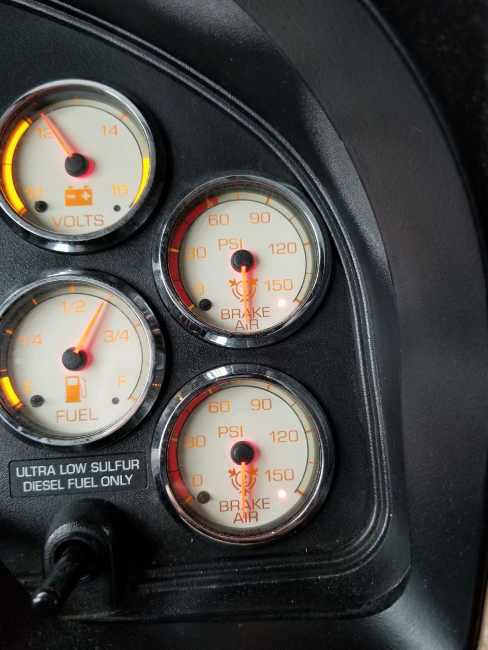

    while driving I can hear my fan start engage and disengage couple time and then both air gauge go all away down and stay between 0 and 150 psi with the alarm on, after little bit it comes to normal and says at 120psi until fan kicks on again, and in the end it goes down again and fan stat working all the time non stop. what is it?

  5. egdmitry
    egdmitry Bobtail Member
    13
    Feb 24, 2018
    pic

    Woha! that's weird no air but the truck brakes did not lock up yikes!!! my best bet is take you truck @ TA have them put the computer to it have them run the codes for $85 bucks begin their so you don't waste too much money

    The air pressure gauges are electronic pressure sensors plumbed into the primary and secondary air lines in the dash. When the gauges point down at 6 O'clock that is a diagnostic indicator that the body controller is not seeing the sensors properly. This is an electrical problem.
