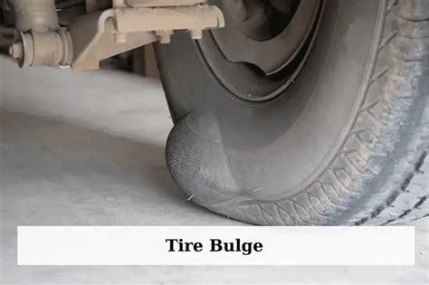

    I shut down about an hour ago, all the tires were fine. I was just finishing dinner and BOOM. At first I thought I'd been hit, but I'm inbetween too trucks, both of whom were poking their heads out going "wtf was that?"
    I take a walk to the back and find this: 20240124_202544.jpg 20240124_202531.jpg
    Any thoughts on why/how the tire blew while sitting still? No real use of the brakes all day, trailer has a tire pressure system so it should have been sitting at 100 psi.

    Hard to say. Goodyear cap it looks on a Michelin case. Too many possibilities.

    It's just weird. Sidewall blowouts usually happen because they got hit, but I would have expected that to happen running down the road, not an hour after shutting down.

    I usually see sidewall blowout after a tire has been run flat. Possibly it was stressed (old case, run flat, case damage, etc) before the cap was put on. Just no way to know without inspecting. And, sometimes things just fail.

    My best guess, after seeing this type of blowout several times is that something got caught in between the tires and it created a soft spot in the sidewall.
    It is possible that this was just a sidewall failure after a tread separation occurred.

    We have had several side wall and other blowouts sitting in the yard. Actually had the neighbor across the street call me once to make sure I was okay.
    all of them were caused by something penetrating the rubber and either damaging the steel cords or allowing road salt to eat at them producing a ticking time bomb.

    I bet it has a old date code on sidewall.. once age kicks in they blow running empty sometimes.

    @SmallPackage may be able to tell.
    On my phone it looks like the inner liner leaked. Something like this…

    I has one blow out at a stop sign. How many miles on them? My tire the outer shell separated but inner casing stated together. Sounded like a shot gun blast.

    The likely culprit is a bad valve stem. Very slow leak, constantly being reinstated by the tire management system.
