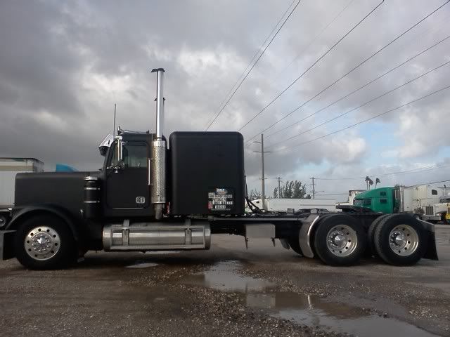

    well its done ive lowered my truck up front wow what a difference ride,feel,steer and look wise all +++++ no negatives the steering even feels softer, i know its weird but true.
    i ended up having to put new u-bolt clamps of course, 3 new spring pins,4 shorter peterbilt shackles and i revesed the location of the shock perch and instaled new shorted shocks.
    here are some pics..
    before:
    after:
    BEFORE:
    AFTER:
    back down to sea level lol

    before you would be able to fit your head between the large fender gap now you can only fit 3 fingers wide thru it.
