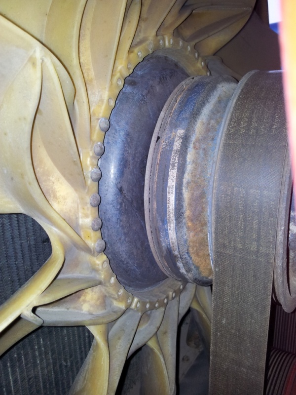

    Fan clutch is slipping. 200* at idle and it's a pain to pull hills.
    How do I lock in the fan hub? Some of the older IH dump trucks that I worked on could be locked in by screwing in a bolt making it one assembly that runs the fan all the time.
    Can the same be done with the ISX?

    Alot of the horton fan hubs have a place where you can put 2 bolts in to lock it on. I beleive they are 5/16 coarse thread. They should be grade 8, and make sure they are pretty tight or you'll just break them off. If your's has the spot for the bolts, you'll see 2 holes on the front of the hub, then spin the fan till it lines up with the threaded holes behind the clutch.

    I could see them if I remove the radiator :biggrin_2559:
    I'll try to get touchy feely with it soon.

    You should be able to see the threaded portion on the backside of the clutch if it can be locked in.

    I see the holes on the backside, but there's nothing on the front of the clamshell.

    Sorry your dead in the water the spring loaded hortons use air to release and are spring loaded so they are normally locked in it get it to the shop asap before it completly comes apart and freeweels i would use a kit masters should be a 256 or 256-1 if it has the single bearing the kit masters holds up a lot better then the horton just my .02
