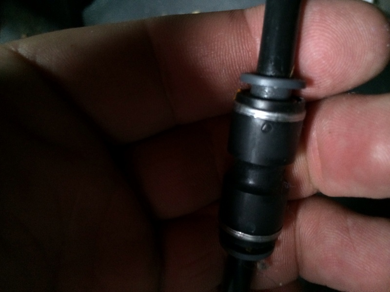

    I want to unhook the airline going to the seat so I can hook up an air chuck. Looks like maybe the current line is crimped? Do I just cut close to the current coupler?2010 freight liner cascadia.

    Why would you have to cut anything? Just unscrew the fitting, either from the floor or the seat, then connect whatever you want to.

    There may be a plastic ring instead of a brass fitting. If you have the plastic ring drain your air tanks, push in on the ring while pulling out on the air supply line. Should come right out. If you are going to add the air chuck, more than likely you will need to add a T somewhere, which means changing your seat air supply line.

    It came with a T already. Here is the picture of the connector I have. It's a little dark.

    That is a quick connector, do as said above, drain all the air out of your tanks, then exhaust the air out of your seat. This takes the pressure off the line and then you can push in on the little collar as you pull the air line out and it will come right apart.
