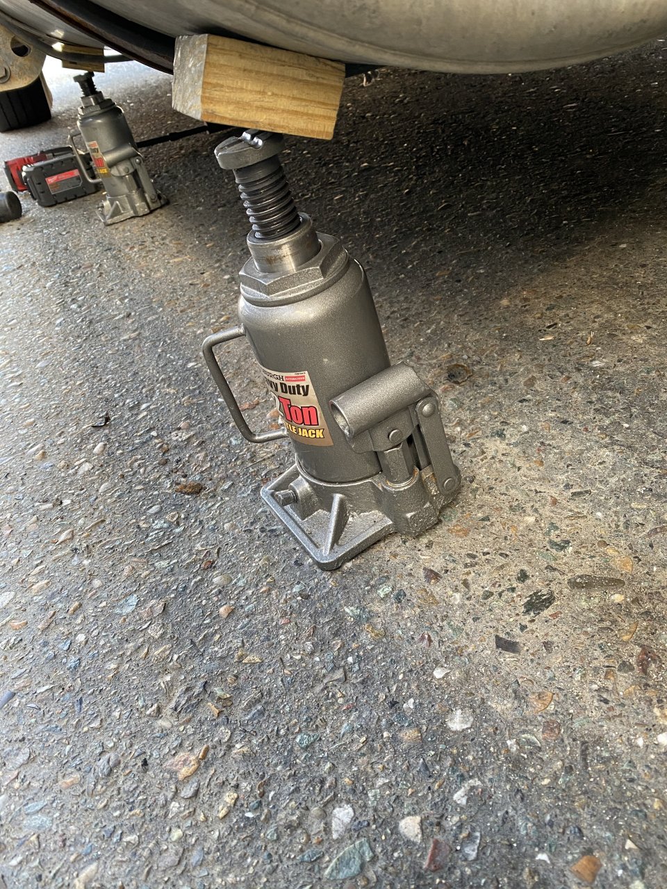

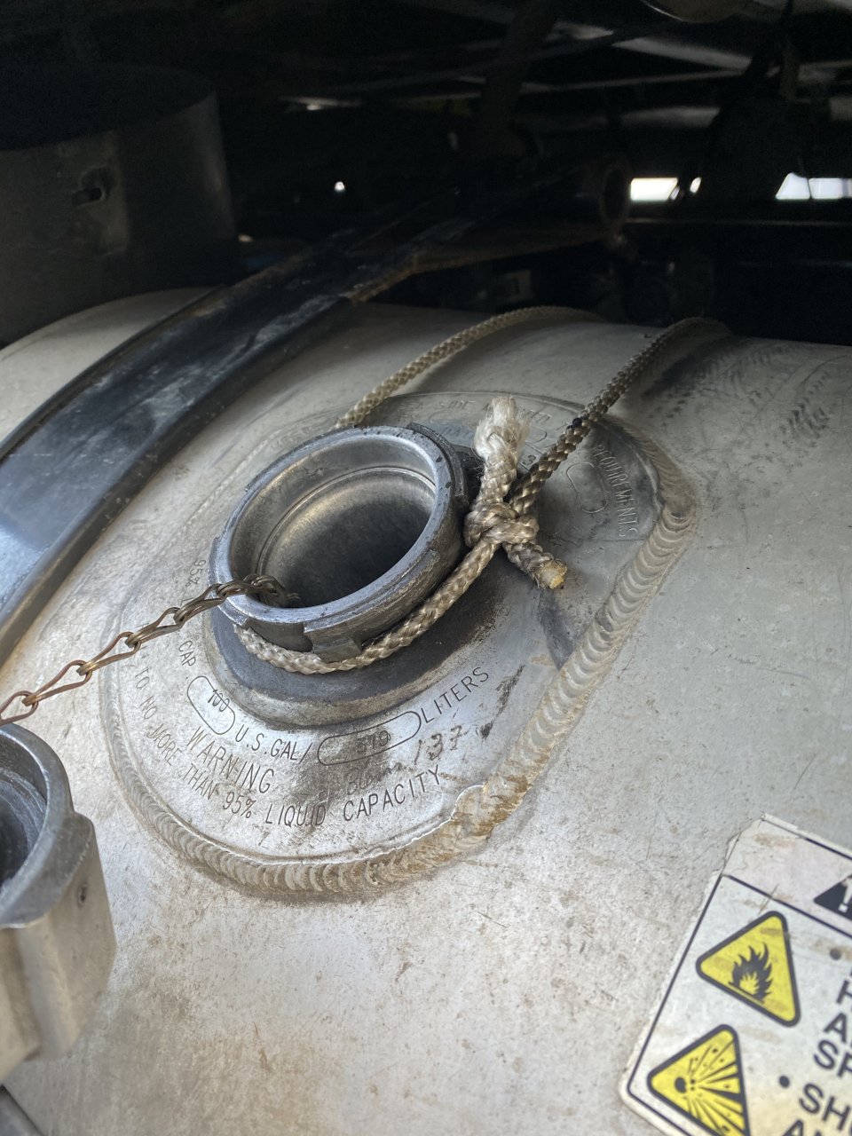

    I’m getting good results by placing the bottle jacks at an angle and pulling with a rope around the fuel tank cap. I’d say also putting grease under the straps should work wonders. My straps are in place while I am doing this. I’ve loosened them quite a bit, but not all the way or else the strap will come off the mount.
    Thank you all for the ideas.
