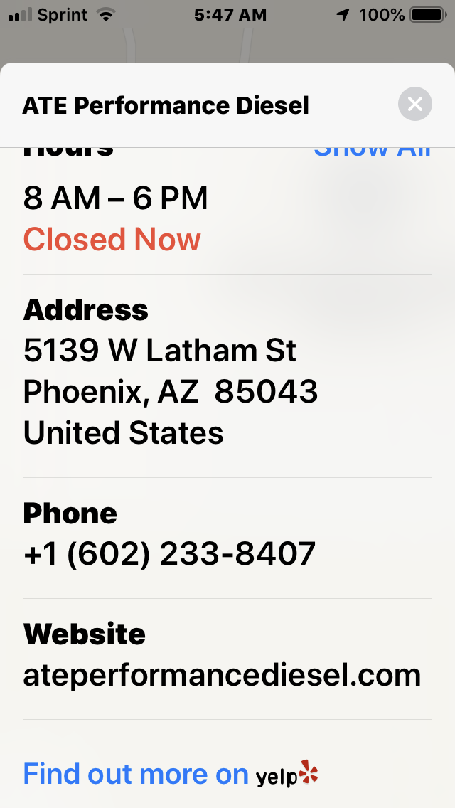

    5E18C4EA-80A7-4A36-8E91-4A3B9C20467A.png They call it a re-power, and these guys are specialists, give them a call.
    Rame and FlaSwampRat Thank this.
  7. AModelCat
    28,871
    154,581
    Still doesn't legally make the truck a glider.
    An owner can do whatever they want with their iron. Skirting the law is a risk you're taking though.
    FlaSwampRat and Bakerman Thank this.
