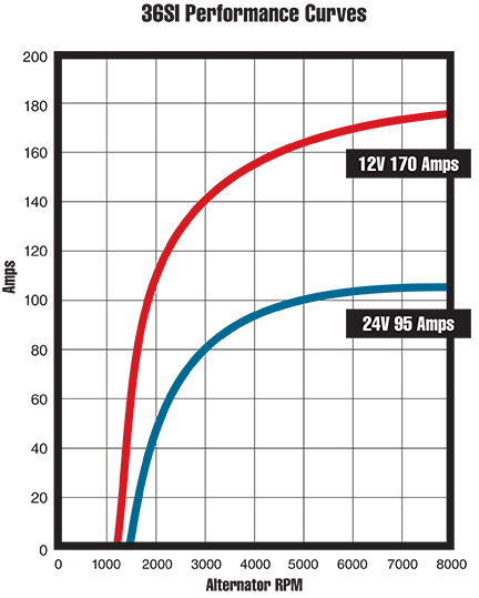

  4. Hanadarko
    Hanadarko Independent Owner/Operator
    2,962
    927
    Oct 1, 2009
    Midwest
    If this thread is related to your "battery" thread, you have less options for alternators in an S60 engine.
    The best I have found (so far) is a Delco 36SI. It's 170AMP.
    (High output at idle -100 Amps at 2000 alternator RPM presuming around 750 engine RPM with the correct pully)
    BobTheCar Thanks this.
