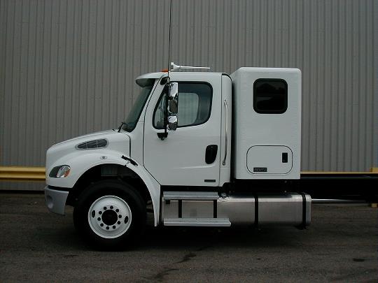

    Google Bentz Sleepers. They have a cool 36'' add on sleeper. You could give them a call and they could give you an estimate of cost and advise on if your wheelbase would need modified.

    Look at this picture.
  11. bogdan
    bogdan Bobtail Member
    5
    Sep 6, 2010
    looks great. it's yours ?
