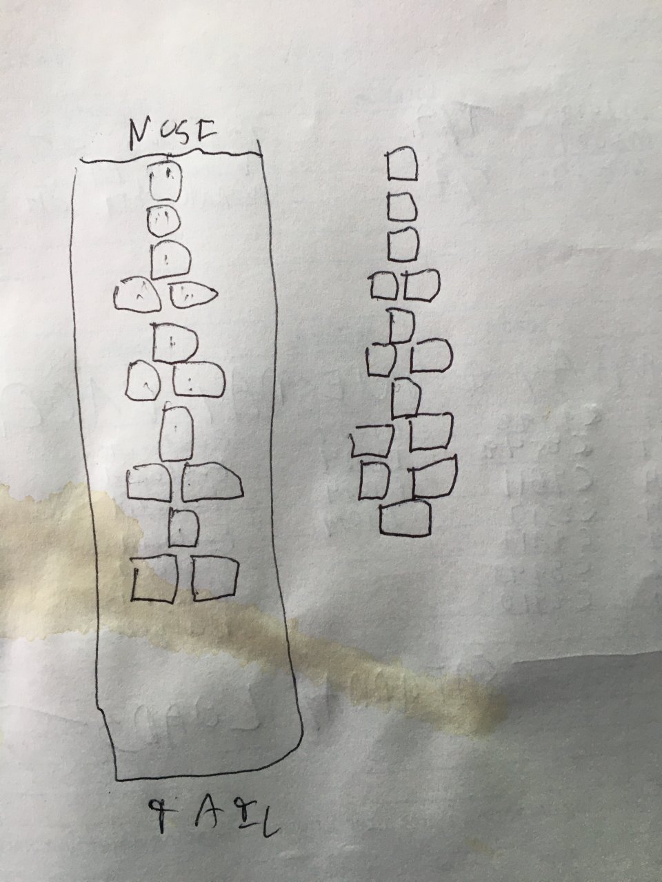

    F60327AF-CB80-4CC6-90F5-89D87A4E8AA2.jpeg Not the same in a van . Single three out in the nose center line of floor, then alternate
    I like they way n the right better. Put two or theee straps across they rear drawing forward on last row. For a little extra safety you could put a few straps middle point of load.

    Can also nail dunnage to floor on the sides of the singles or use grabber plates or anti skid material
