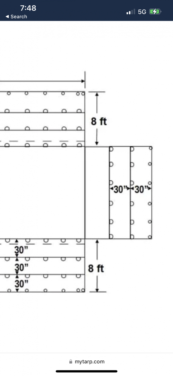

    I found this set Sigman 8' Drop 3-Piece Flatbed Lumber Tarp Heavy Duty - 3-Piece Set - 18 oz Vinyl Coated Polyester - 3 Rows D-Rings
    I also question if I should find 10' drops, since I am a step deck.

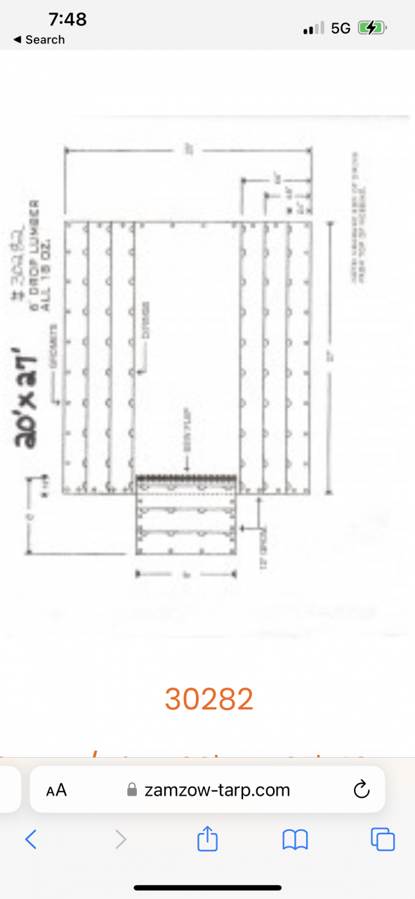

    Mainly, there are lumber and steel tarps. You wouldn’t buy lumber tarps to tarp steel or for general usage and vice versa. Lumber tarps are for lumber only. Yes, I know people use them for other stuff, but, it’s not worth fighting them and ending up with a compromised tarp job. Mostly, it’s big flatbed companies skimping on the equipment their drivers are given.
    The tarps you linked are missing the wrapover flaps on both ends. Look at the screenshots below and you’ll see the Zamzow set have a sewn seam inset 12” on the flap end. That gives an overlap of 12” on each of the wrapover flaps. This is crucial to keeping stuff dry. No way would I buy the linked set. Further, you’d want a 2-piece set of lumber tarps, so you only have one overlap. When you overlap, you want to very tightly bungee your rear tarp to your securement straps. This way your rear tarp can never walk back, going down the road.
    My lumber tarps were 8’ drops on a skateboard. I’ve seen guys try and tarp a step deck with 8’ drops, but, the drop was always a compromised area. I think I’d try and steel tarp the upper deck like a present and lumber tarp the lower. It’d be really tough to do, though.

    Linked tarp.
    Zamzow tarp.
