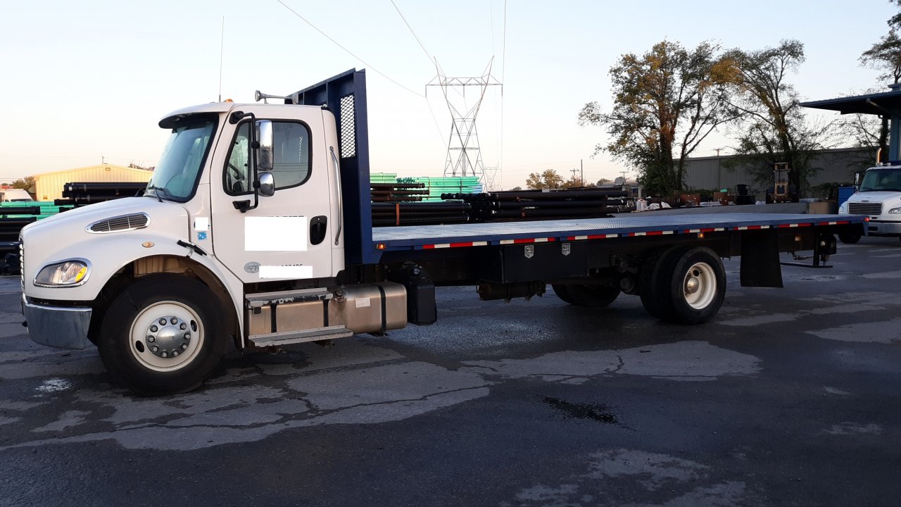

    I drive a Freightliner M2 106 Single Axle with a 27' flatbed on it.
    It has the multi-leaf spring suspension. We haul very heavy loads of underground water pipe and components.
    I am certain beyond a reasonable doubt the rear suspension is shot. We noticed the truck leaning and took it to a shop to get checked out.
    How would you verify the suspension is worn out and needs replaced ?
