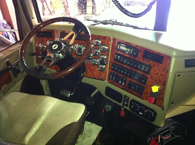

    plz post a pic! I sugest dashboard is similar with shaker
  10. stolpsaddles
    stolpsaddles Bobtail Member
    18
    2
    Dec 13, 2012
    Langley BC
    Here are a couple of pics
  11. Pablo-UA
    Pablo-UA Road Train Member
    7,604
    1,642
    Oct 11, 2010
    Borispol, Ukraine
    do you have small text display in center of dashcboard?
