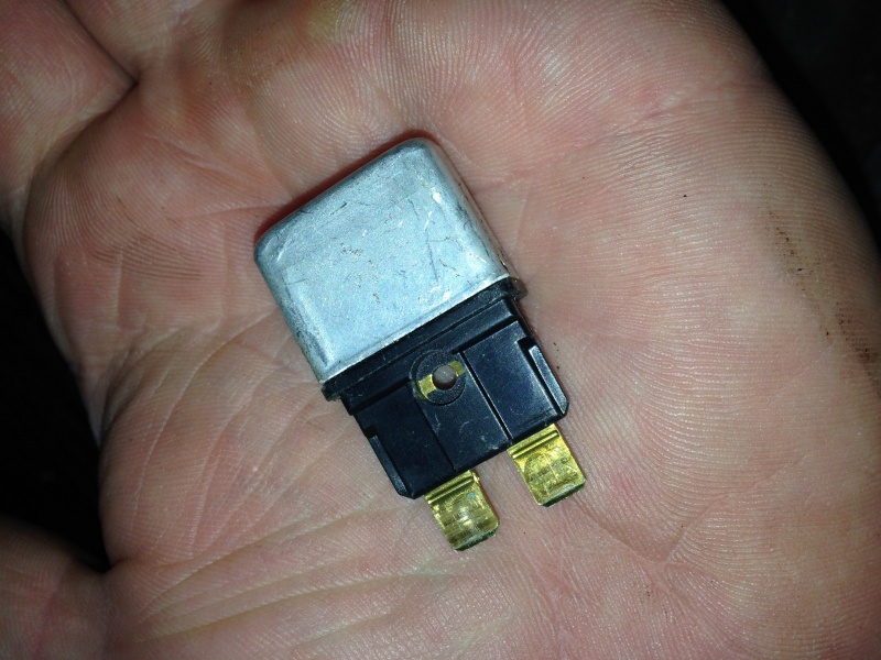

    I traced the main jacketed lead from the pump at the back of the truck all the way to the battery box where it goes through a high amp bus (not sure what this is). So, from the pump to the battery box there are no visible inline fuses, other than inside the battery box where it goes through the bus to the hot terminal. high amp bus.jpg

    That's it. It's a high amp inline fuse. If you have 12V across it then it's okay. Next is the switch box. You'll have to check 12V across that key switch. Looking at a couple of them lifts there are some I've seen with 2 switch fuses which I'd say is in that switch box.

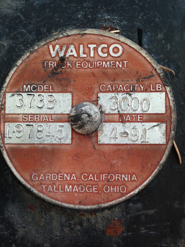

    What model number is that thing so I can look at the right diagram?

    Here it is. 373B.
