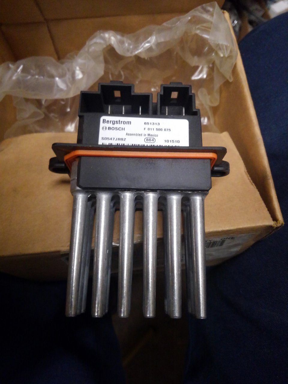

    Doesn't have a resistor, has linear power module. Located below glove box. HVAC mode motor is located to right of glove box. I have had to geartrain come out of time before. It usually takes some time getting it back in time!!! KIMG1077.JPG
