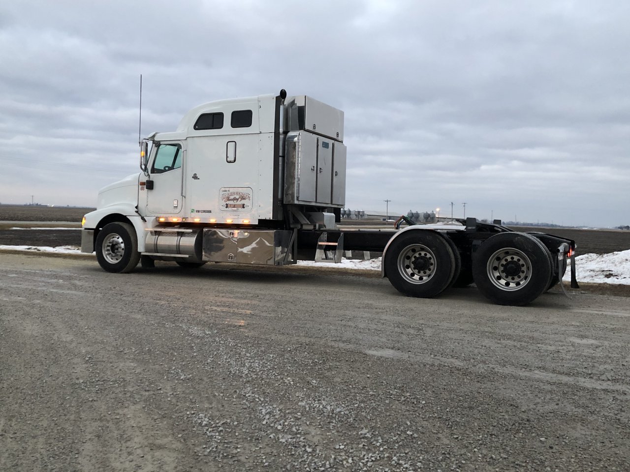

    Mine. 3 door with a 24x24x60 box mounted on top. 2A04D1A1-AE3D-4A1B-9167-39F00EECB784.jpeg Burner fab full height 5 door cabinets are bad to the bone too though.

    So what do you put in the upper box
