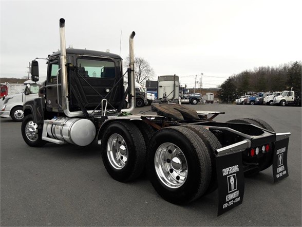

    Anyone installed one on a Mack pinnacle? It has the factory dual exhaust with the X brace thing like the truck in this picture. The headache rack is a cabinet style with the three doors. Seems like it would look pretty strange mounted behind all that mess and that far from the cab.

    Usually they’ll sit right behind stacks and all fit in together.

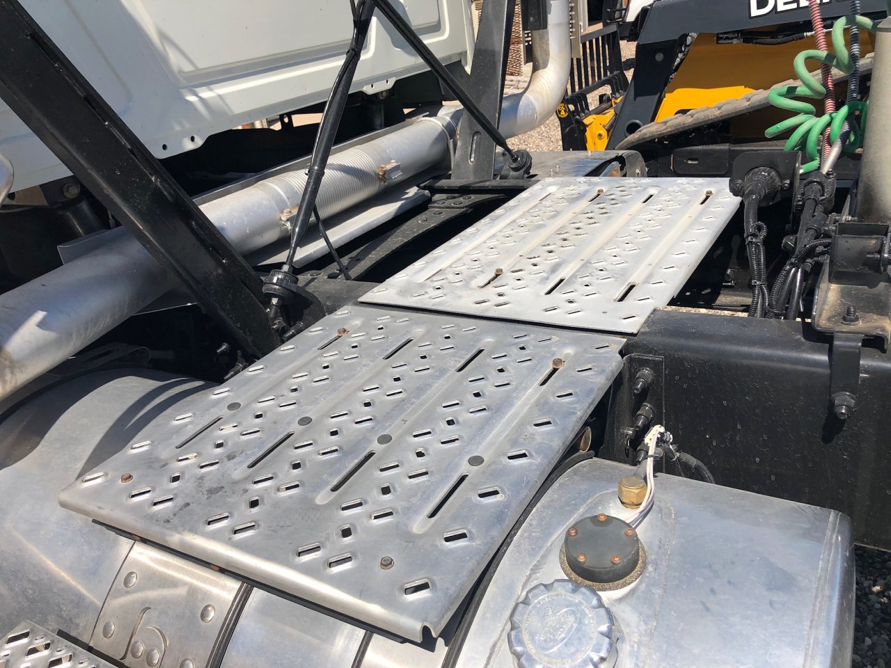

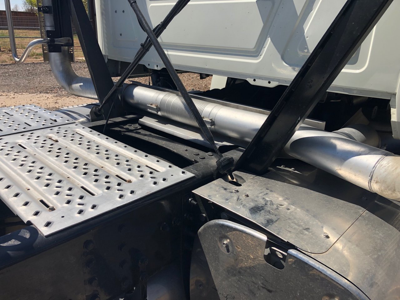

    3D5AB2A9-BAD1-4B67-BBB1-480C3088696D.jpeg 6D526302-CB7A-4817-AA87-2652AEB2C0D1.jpeg AC8D53DC-E5DA-4BCA-B45E-219ABD5BB611.jpeg Ok so I looked at this in detail today. With the braces, diesel tank, DPF, etc the closest I can get the headache rack is nearly 3’ back from the cab. There is stuff in the way preventing using the u bolts any closer to the cab than that and I am not talking about the catwalk I know it is easy to move. There are brackets for the tank, DPF, etc. in the way.
    I think I am going to punt and look at other options.
    booley, cke and PoleCrusher Thank this.

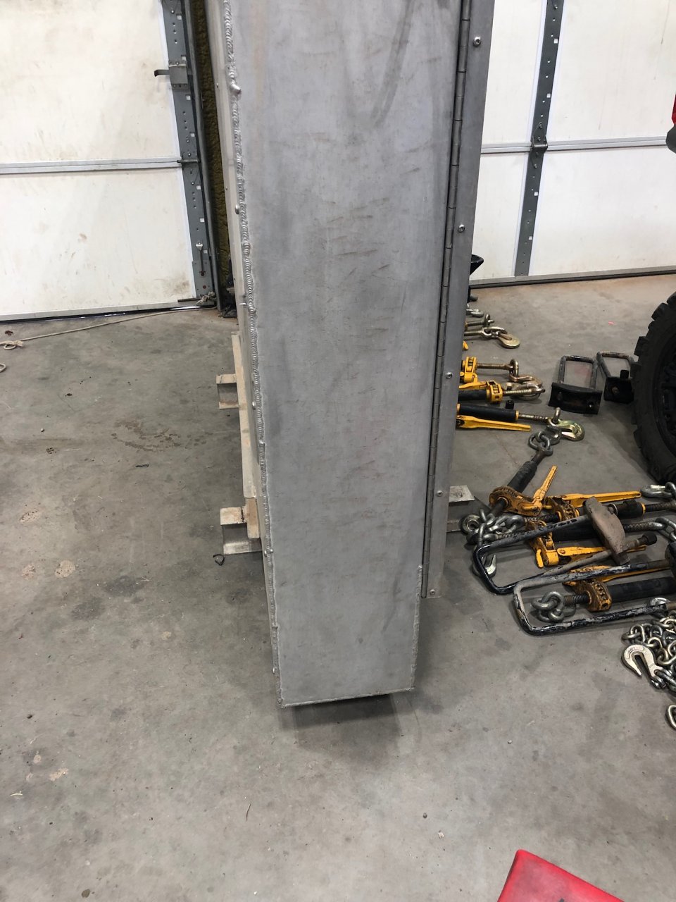

    They can customize anything you want. I did this on a cabnit I got a deal on to fit around my 1 stack international. 4742C264-A312-4541-8743-1D797E4E7C9C.jpeg 3EA7F5A3-315B-49DC-80B2-C414863387FB.jpeg 12DEE375-76D0-4A7D-A8CD-3F4DC9A86474.jpeg
    Long FLD, cke, PoleCrusher and 4 others Thank this.
