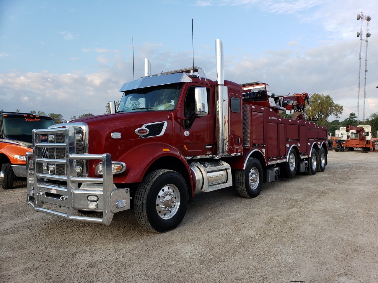

    What were your impressions driving it? Did it drive okay or was it really obvious from a driving point of view?

    It was actually pretty nice. Drove, shifted and everything felt just like a semi or straight truck. The biggest difference is being about 80k in a single unit vs like a tractor trailer. Idk kind of hard to explain.

    Still seems like an odd set-up. Placing that 4th axle farther back (placing 23K on a single steer) would have lessened the overweight situation on the drives. Granted, it would still be at least 9800# over-gross, but by running a 23K steer axle at 3K over the 20K limit, the tri-drives (allowed 45K if over 10') would only be 51,800...or 6800# over. That would also give enough "extra" on the mfg specs of the axles, tires, and suspension to allow for a truck to be towed without over-stressing components. As it is, no typical truck tire is going to be rated heavy enough to use on the drives if they are actually towing anything...pushing it just running down the road empty. That's another reason why, whether recognized or not, it was bordering on silly specing it with just a tandem drive. It also limits who will be willing to buy it if/when it needs to be sold. Nobody from a state that DOES recognize the extra axles (and will require them) will be interested in a truck that doesn't have the axles to be legal.
    But, it ain't my money that bought it, and I'm not the one risking the overweight citations every time it hits the road...so my opinions really don't matter. Sometimes I wonder what it'd be like to have more money than brains...but in the end, I'm glad that's a problem I don't have.

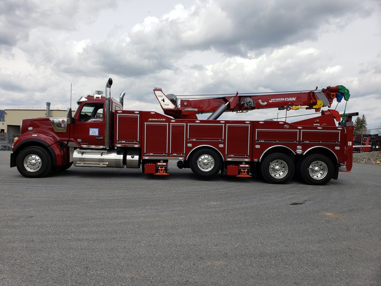

    You don't have to worry about over weight citations, as they sit they need a blanket weight permit just to drive empty. Anything over 65k as a straight truck does in all but a handful of states. Violates Federal bridge laws. Now, once loaded they are typically exempted from axle weights thanks to a change in the FAST Act a few years back.
    As for tires, they run 11R24.5, so it is a bit over on the tires. Not much, the axles are spec'd for 54k (have a slight spead to them) and when you do the math for picking a disabled truck you add about 9 or 10k to the tandems is all. As you know from when you towed, leverage is your friend and the rear axles simply act as the fulcrum in the lever.
    The other reasons for tandem drives are tow capacity -the capacity is based on a wheel base and overhang formula, having a tridem gives you more overhang and reduces the amount you can lift with the underlift (the more overhang beyond the center of the drive the lower lift capacity due to steer axle unloading).
    Also, and this is Jerr-Dan specific, the way their rotator platform is designed does not allow for a tridem axle spacing. They have the most stable outrigger platform on the market but the trade off was frame space for traditional axle spacing. These trucks lift like a beast, our 60 T out lifts the Miller 75 T at the same boom extension, especially off the rear corner where rotators are weakest.
    Now, for those that are not really concerned about weight distribution we also offer a single steer version of this truck with a steerable lift axle between the outriggers. They drive a bit squirrely when not towing but some guys want them.
    FlaSwampRat Thanks this.
