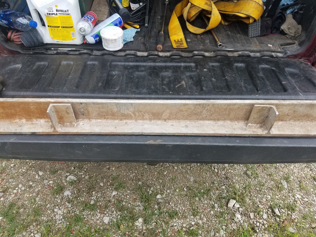

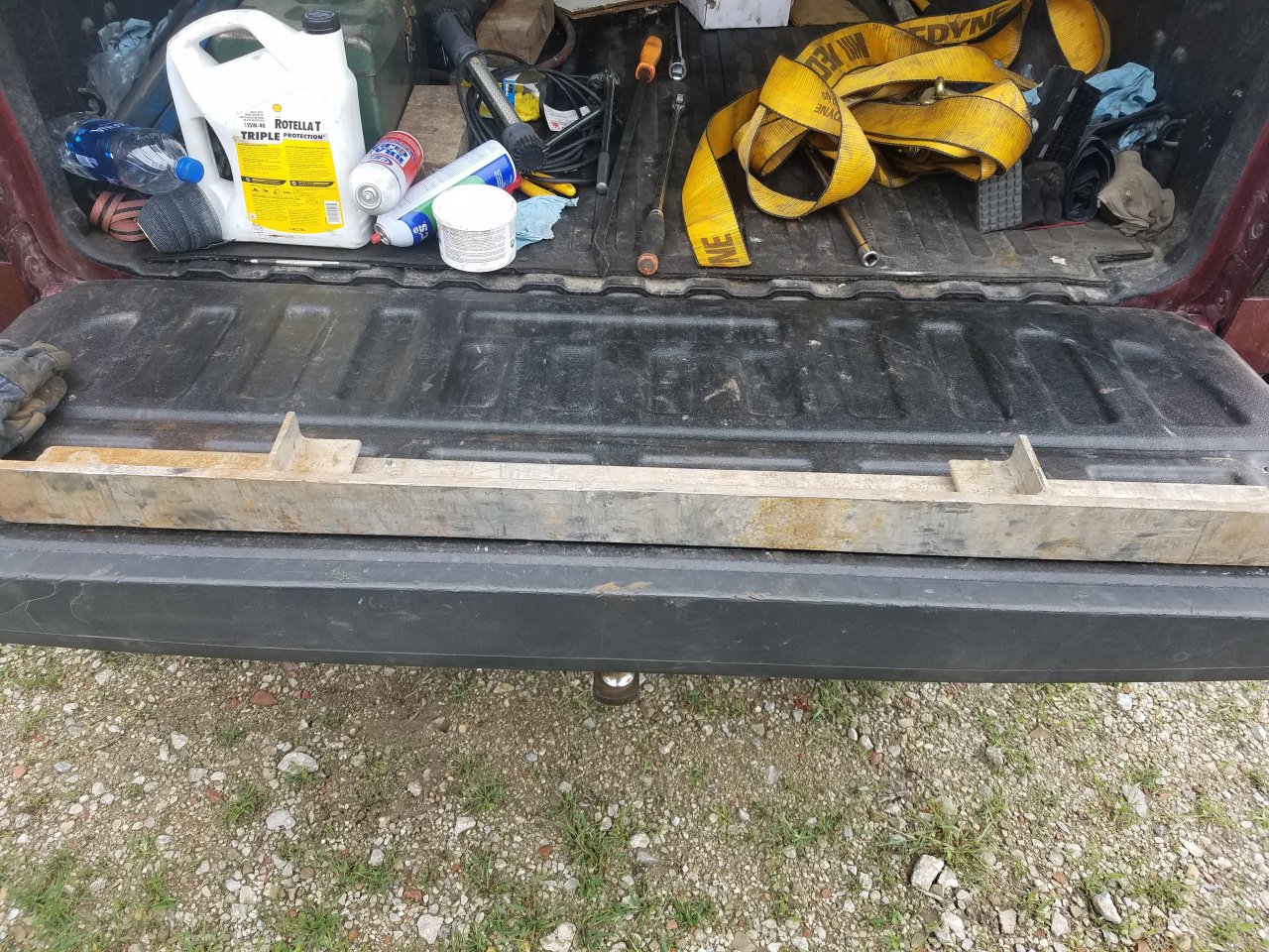

    I had an issue delivering a load of brick about a month ago. He dented my rub rail pretty good. Then he said he reused to unload me because I was standing there watching him like a hawk afterwards. He also made quite a mess breaking bricks. I ended up having to get a manager involved there. Unreal. I like the bumper idea. Have any pictures?

    I can get some, it buried in my trl. If i get a chance I will get some. Its just fits into stake pockets and has a large piece of alum angle then out over the edge. Had a local fab guy make it.

    Just one piece of heavy alum angle with two pieces welded on and fit in stake pockets. I cant show you installed because side kit is on and dont feel like pulling for a pick. I had to pull 6 pairs of coil racks out to get this. 15367658388275828903447545093248.jpg 15367658635265232503074434904628.jpg 15367658798165860039824706459202.jpg

    Thanks, that's a great idea. It's also insulting to the offender which appeals to me even more so!

    Awesome idea about the rub rail protector. A simple 2x4 with a few J hooks should work just as well.
