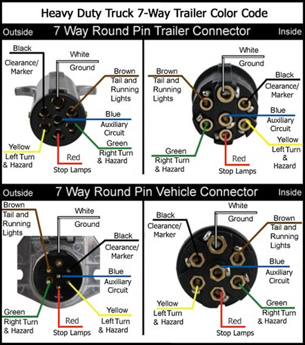

    Check your plug with a test light. If it lights up according to this diagram, your truck is good. My guess is that the trailer has had some wiring wizards working on it and now the whole trailer harness will need replacing.

    The center post, marked auxiliary, should have power all the time. It's for the ABS.

    Checked pigtail at truck and is not Getting any power on one side. Its problem in truck somewhere i just can't figure IT out where.

    What do you mean by one side? Turn signals?

    Marker Lights had power. No power on clearance Light

    Marker and clearance are one and the same... black wire.
    Tail lights and license lamp are on the brown wire. They should be separately fused and sometimes each have their own relay in the fuse box. If both fuses are good, swap the relays and see if power swaps on the brown and black wires. If it does, you have a bad relay.
