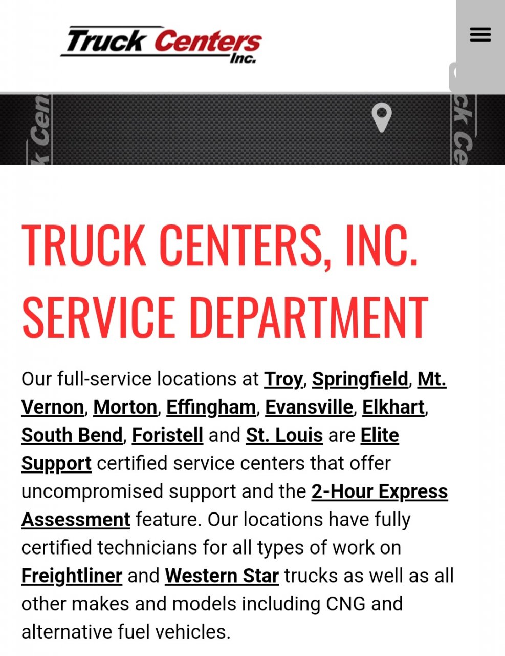

    I preemptively pulled the filters around 620k and got them cleaned (blow+bake+ultrasonic) and reinstalled because of this code, cost about $2k. never got any other codes except the "notification" timer one. the filters were only 40% soot restricted on the vacuum test.
    "cleaned" filters lasted another 50k until I got a "SCR closed loop" permanent fault code. I got another 50k after that before truck went into 55mph derate for SCR closed loop, then 150 miles until 5mph derate and red STOP light. the original filters had become cracked after the cleaning process and had been passing soot into the SCR for a year, visible black on the exhaust pipe. should only see white ash.
    new oem filters and new sensors to the tune of basically $10k, and SCR conversion efficiency back at .99... that's lucky i guess. if scr had been soiled it would have been about $15k for a new 1-box. new filters are $2k, if your cores are not cracked. if i had spent $2k on new filters instead of $2k on the cleaning process I'd have saved $10k in triage. but u know all this isn't in the cascadia manual now is it.
    truck centers inc won't charge you $6k for new DPF filters, they have a lot of convenient locations, and they have a handy 2-hour diagnostic dogma from check-in to "here's the deal". filters are $2k for 2 if the cores are good, $3k if not, and the only way it's gonna be more than $1k more in labor for that job is if all the sensors are goopy from soot and it takes hours and hours to coax them all to come out of their little toasty damaged threads. if you replace the filters before the truck gets tuberculosis the sensors won't be goopy in the first place.
    Truck Centers, Inc - Heavy Truck Sales, Parts, Service, Training, and Collision Repair in Illinois, Missouri, and Indiana
