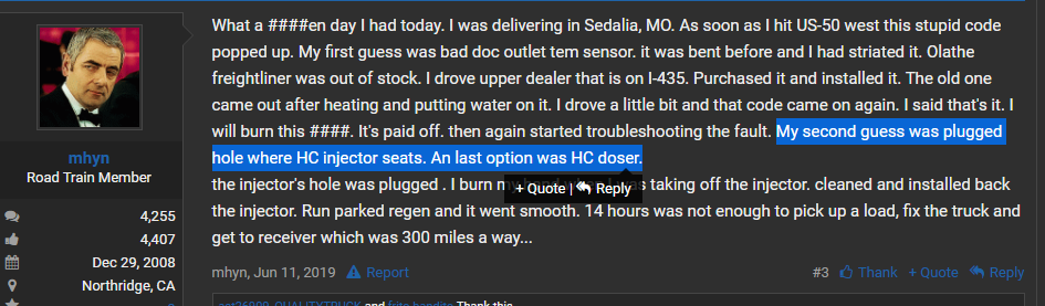

    What a ####en day I had today. I was delivering in Sedalia, MO. As soon as I hit US-50 west this stupid code popped up. My first guess was bad doc outlet tem sensor. it was bent before and I had striated it. Olathe freightliner was out of stock. I drove upper dealer that is on I-435. Purchased it and installed it. The old one came out after heating and putting water on it. I drove a little bit and that code came on again. I said that's it. I will burn this ####. It's paid off. then again started troubleshooting the fault. My second guess was plugged hole where HC injector seats. An last option was HC doser.
    the injector's hole was plugged . I burn my hand when I was taking off the injector. cleaned and installed back the injector. Run parked regen and it went smooth. 14 hours was not enough to pick up a load, fix the truck and get to receiver which was 300 miles a way...
