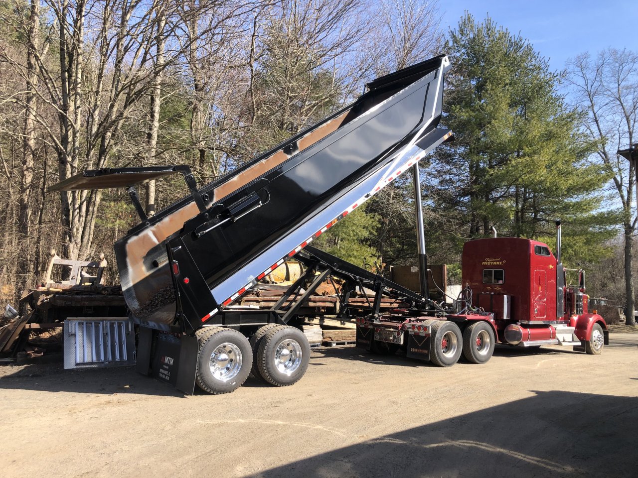

    Depends on how it’s spec, my uncle has an older trailstar with an aluminum 28’ tub/steel frame on center point and a hydro tarp, 11r24.5s which weighs 13,920, last year I purchased a new MTM 28’ steel trailer, quarter frame, air ride, tall 22s, electric tarp which comes in at 14,200, a full frame will probably be closer to 15 though but I hate full frame trailers and I wanted to loose a little weight to make up for the bunk, I can still get 32 ton in legally,
    Oh and a high lift gate is a must ar 450 5/16 floor 3/16 walls 8F7A68F5-85E6-4744-883C-55335E80E85C.jpeg
