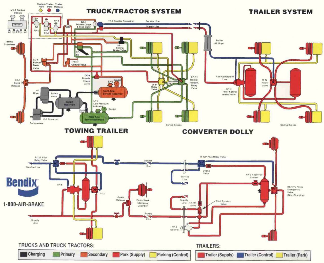

    B17F662B-C8C9-4A3E-BCD4-C0E38FF031CA.jpeg There are multiple valves in the system. Without looking for a specific diagrams for your truck/ trailer this is how all brakes systems work. The only differences is where the valves are located and which valves have been merged together. Like with Freightliner the tractor protection valve has multipe valves incorporated like the double check valve and I think another. And most anti compounding valves are incorporated into the service brake release valves.
