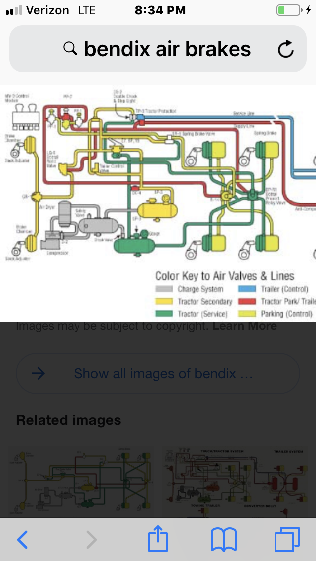

    BD40501C-CEE7-4FE2-9450-EEE742D04D6C.png Bendix has some good diagrams online. I’ve often seen them at dealerships, big poster on the wall. Would be nice to have one of those!!! This one is listed as Freightliner.
    Dino soar Thanks this.

    The diagrams online all show a wet tank and then a primary and a secondary. But this truck has a third tank on it.
