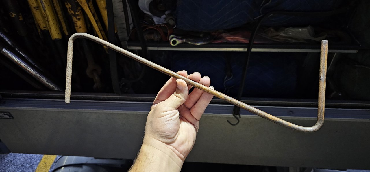

    For getting straps through the rubber flap I bent a piece of 3/16" rod into a Z shape. Push it up through the flap from the bottom, hook the strap on, then pull it back down through the rail. No more fighting trying to push a strap through from the top.
    cke, lual, Iamoverit and 3 others Thank this.
  6. OldeSkool
    OldeSkool Road Train Member
    1,642
    4,439
    Jul 17, 2018
    New Hampshire
    Wow that’s a good idea!!

    I just grab the rubber with my left hand and with a little push of the right hand the hook falls right through. The OP might need to adjust his hooks with a big hammer, some brands are spread out to much.
