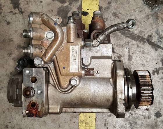

    I have run into this problem, it could be the dosr injector clooged up ornot functioning. 2nd i changed the block doser and fuel compensation pressure went above 70 which is good but temps across the filters didnt reach the what they should. Lastly I changed the little manifold on the fuel pump, and it solved my problem. It is held on the fuel pump with 3 bolts. shopping.jpeg
    stevez57305 Thanks this.
