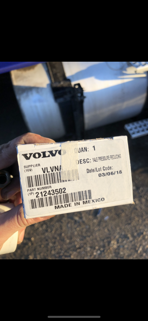

    So is this the pressure regulator that controls the air that goes into the AHI module? If it doesn't put out the right pressure then I would have this fault code?

    Yes you’re correct. But still need to verify that cause there’s a chance AHI pressure sensor reads incorrectly. You can see more info using Volvo PTT and you can control AHI module in a way.
    AHI module is expensive compared to air drier filters, buy them when they are on sale, most dealers have monthly specials, replacing them annually before winter helps.
