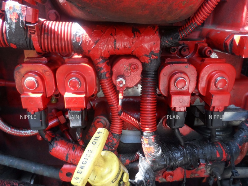

    Hey PAWPAW are they all the same or is there a difference between fuel and timing solenoids, I ve noticed two of them have a little nipple in the front,right above where you plug in harness. Are those with nipples fueling or timing. mine is set as nipple,plain,plain,nipple . Is yours set the same way? Solenoid 2.jpg

    They are different . Mine doesn't have metal gaskets , just an O-ring. You got the order right. You can switch 1 & 4 , and 2 & 3 .
