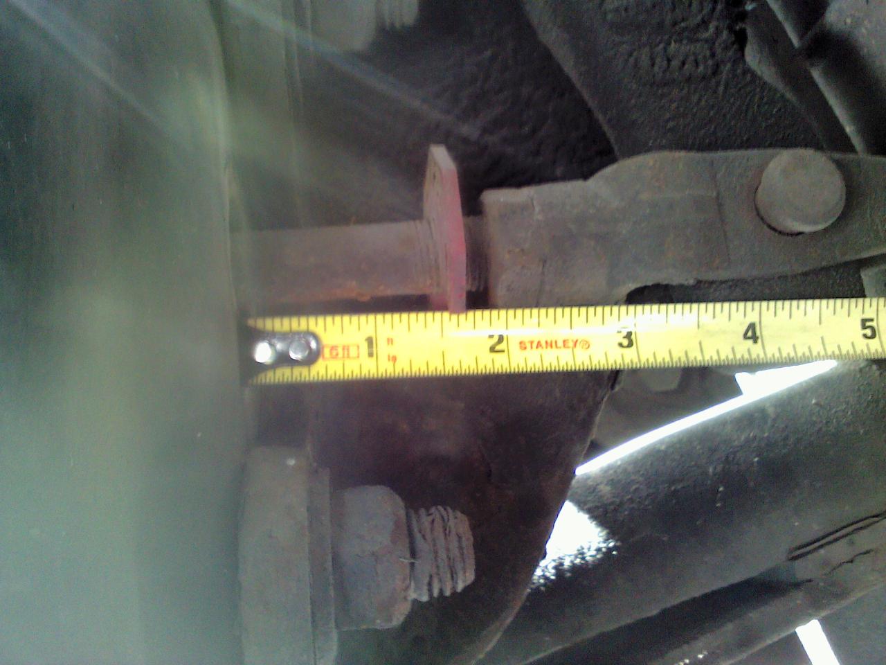

    I put Brake Safe indicators on truck and trailer. Drivers and mechanics seem to love them, and haven't had a brake related issue on an inspection since. A quick look and you know where the brake is.

    Supply air to the cans put a zip tie on the threaded rod as far as you can closest to the can. Then when the spring break is applied it will show you how far the rod has traveled.
