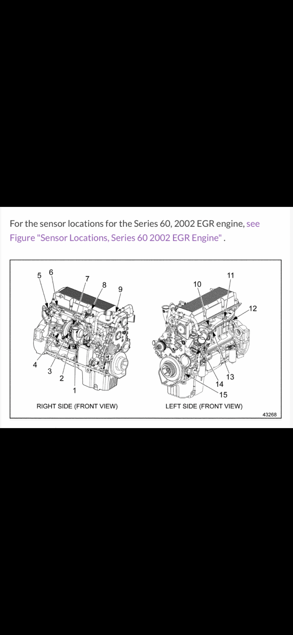

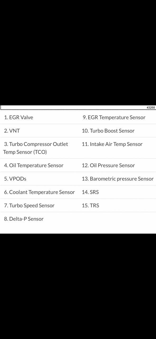

    CEL going on and off. Did you pull the blink codes? Are you hearing the fan kicking on and off? Or is there a light on dash when fans on? I can’t hear it kicking on in the video. That’s got to be a loose connection somewhere, causing the gauge to do that. Temp sensor should be on right (passenger) side, on the head. near the back of engine. Between the valve cover and exhaust manifold.

    Aug 8, 2015
