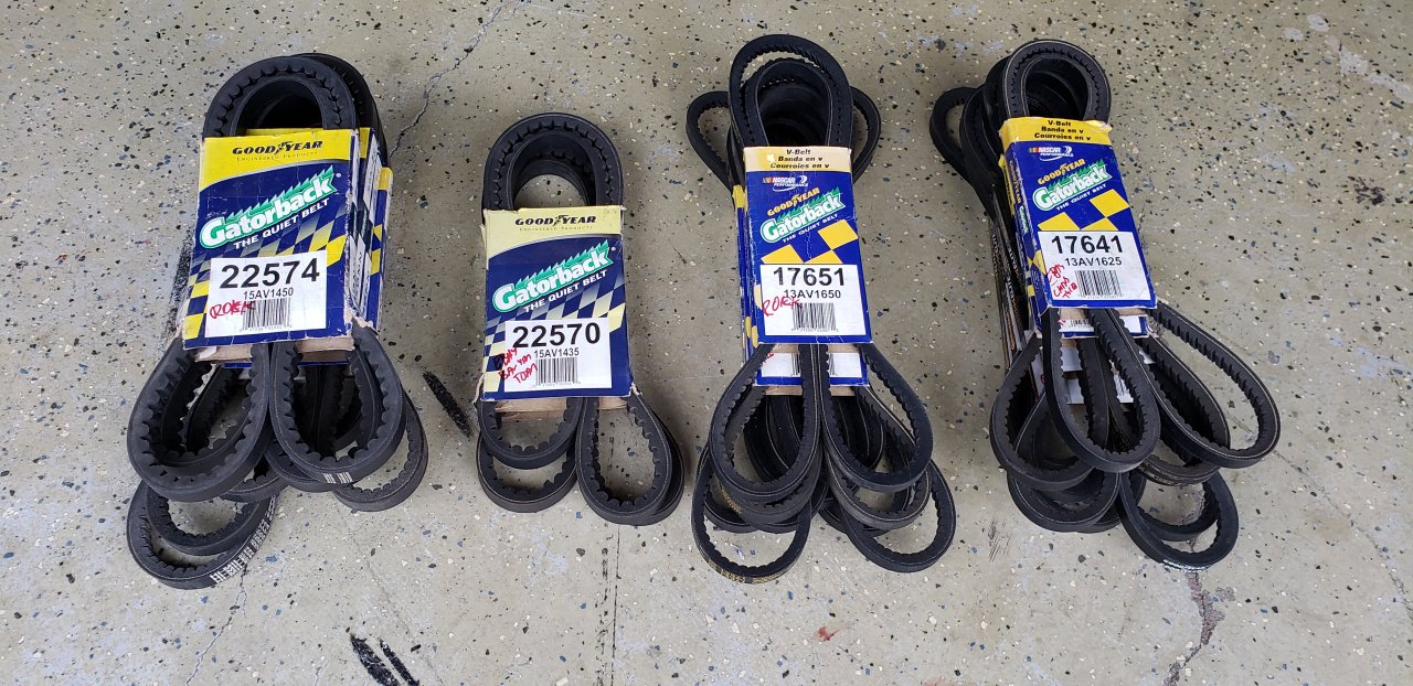

  9. Slow302
    Slow302 Medium Load Member
    348
    117
    Jul 12, 2013
    MO
    Yesterday i replaced fan belts. It wasnt bad at all. I dont know if 379s with 3406 have bigger fan but i could easily ran belts over mine. Also i found ceap belts on Rock Auto for $.72 a piece. All Gatorbacks
