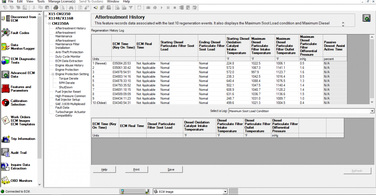

    Been awhile since I looked at after treatment stuff but should be under ecm diagnostic or ecm test and look for after treatment. Should give you the last 10 Regens. Also don't keep performing Regens if it goes into a shop and they look at this and see oh hey it's regening every 30 hours ur gonna end up wasting time and money lol

  10. Brandon0928

  11. TruckerPete1990
    TruckerPete1990 Road Train Member
    8,623
    5,376
    Jul 16, 2012
    Bentonville Arkansas
    Looks good I would just run it. These emissions engines do weird things at weird times. Unless you log it while it's doing one of those weird things it's a guessing game.
