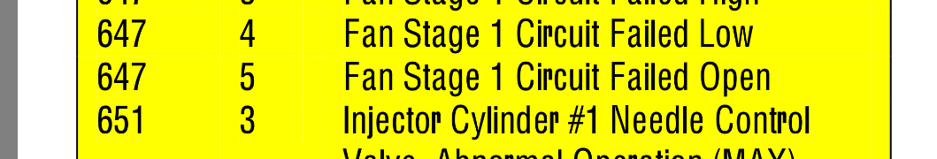

Diagnostic code spn 647, fmi 5. What do you think is the reason? How to fix it? Any advices?

https://ddcsn-ddc.freightliner.com/cps/rde/xbcr/ddcsn/0111-16.pdf -
According to the link Buster Cherry provided, you have an engine fan solenoid issue. What is the engine fan doing? Might be the harness grounded out.
