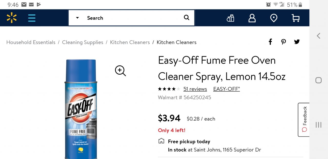

  4. Goodysnap
    Goodysnap Road Train Member
    3,694
    8,948
    Jul 12, 2017
    Follow the instructions on the can.
    Spray, soak and rinse with warm water. Lightly blow dry with compressed air.
    Just like your oven.......... heavy buildup make take a few rounds.
