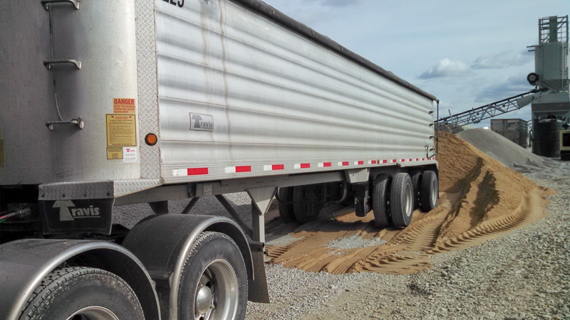

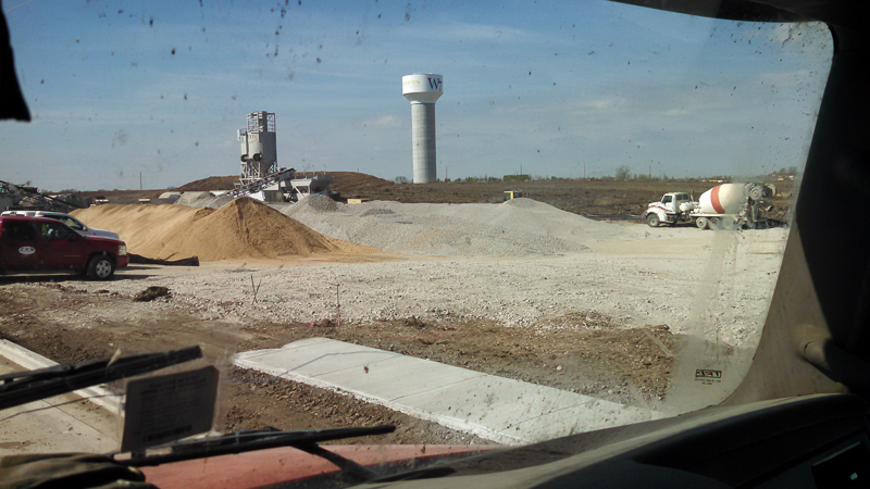

    There are times where we MUST dump even though the rig is not sitting level. We have been hauling sand into a concrete plant where there is no level ground. While our dispatcher and boss repeatedly state don't dump if it's not safe/level to do so. Well several drivers complained about this site, but the dispatcher's reply was get it dumped anyway. They talk out of both sides, if you know what I mean. :mad:
    These pics don't really show how uneven or not level the rig is. If you notice the lift axle, you see that one side is touching the ground while the other is not. The lift axle is raised too. Managed to get the load dumped. Sometimes you need to adopted the thought, if it goes down it goes down.o_O:eek:

    Hi Eaton18, well, IDK, I've dumped in a lot worse situations than that. I'd leave the axle down, seems to stabilize the trailer somewhat, if you're that worried about it, and sand falls out pretty easily. It's mud and frozen salt that I've had trouble with. I've already looked around for wood to run the trailer tires on, or make a little "ramp" with the sand to level it out a little. I know, batch plants aren't usually in the best places, but that doesn't look bad at all. Dump it nice and slow, and watch the ram. If it starts to lean STOP ,although some old-timers claimed, letting it down could be just as bad, and they would continue to dump it out, but I always let it down. In 35 years, ( not all dump truck) I never had one go over.

    Yep, like I said the pics don't really reflect how it was. The tractor is sitting on an up-slope, tilted to the right. The ground is full of large bumps, ruts caused by the loaders. While raising the bed it continued to lean to the right. As far as leaving the lift axle down while dumping, nope, not happening. That tends to blow airbags. I'm not new to this, been at it for just shy of 5yrs now. Just posting things like this for the "new" drivers have an idea what the real world is like. We all state the obvious safety things, but sometimes the real world dictates otherwise. Don't have to tell you about that though. Congrats on a long uneventful career.

    Hmm, never heard of "air bags blowing ", but I never had an air ride dump, and the only axle with air ride was the 3rd tag axle (required in Wis) which I'd leave down, and it did help a little. I never said it was an "uneventful" career, just never tipped one over. I'd say half of my career was dump truck, and while there are things I liked about dump truck, there were just as many bad experiences. Like I say, these loader schmoes are like dogs. They try and get away with as much ( or little) as they can, but if you stand your ground, they usually give in. It's just the same old thing, they think all truck drivers are morons, and we think the same about them.

    Really? I don't know, and it seems they would be much more stable. It just appears by the way they're constructed the bed couldn't lay over much more than what they are while dumping. I guess they would also tend to take the tractor over with them. With these frame-less end-dumps, they break loose, leaving the tractor standing, most of the time. It is possible to have things really go bad, and have the ram break loose from the tractor, not the trailer, and get shoved through the cab, or just have the trailer come down on top of the tractor. The latter would happen if the hydraulic hose broke while the trailer was standing up. That's scary stuff. I've had 3 hoses break or crack. Luckily it's been before the bed got to the 2nd stage.
