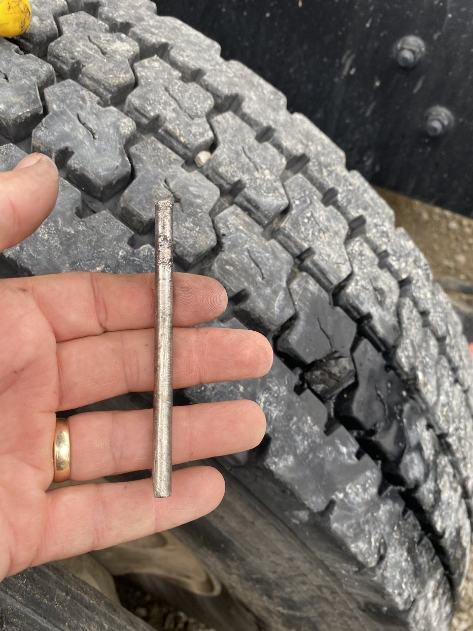

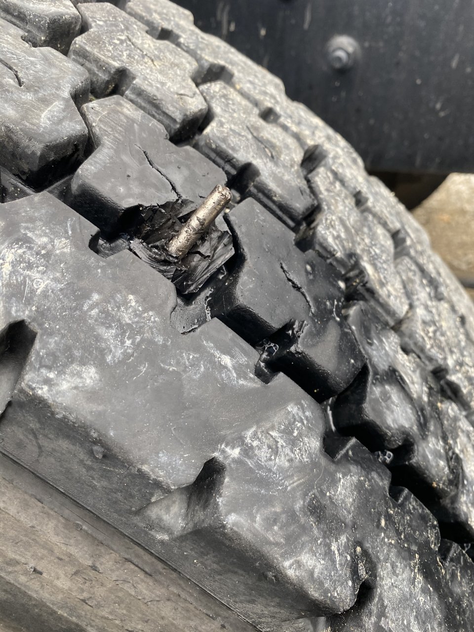

    There’s a lot of info on here about tire ware and different types, but mostly for the OTR drivers. What are you dump truck guys getting the most ware out of on drive tires 11/24.5. I have Yokohama 517 and they seem to be wareing a lot quicker, but maybe it’s normal. Of course there’s the occasional spike in the tire..
