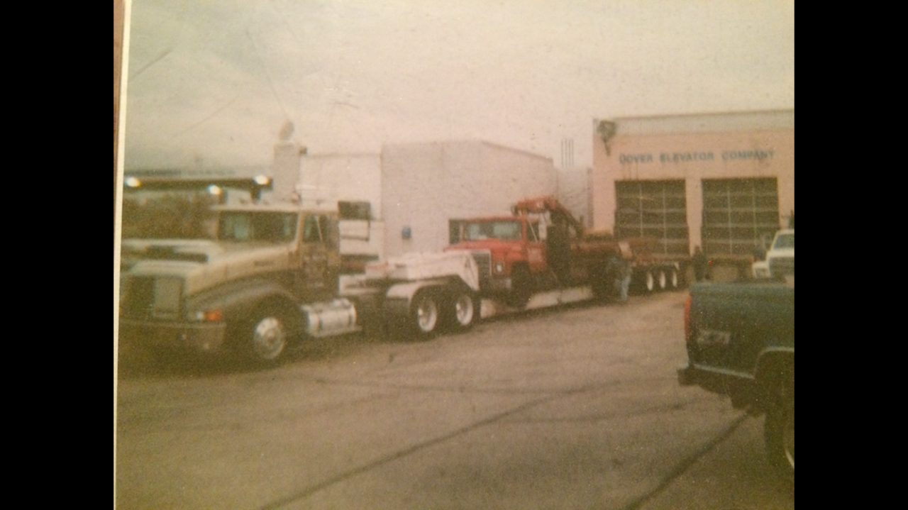

    In my R&L Drilling days we put a lot of miles on DT466 powered trucks. The 1985 model we bought new had over 900,000 miles on it when we retire it, and was still going strong.
    The red 86 international I had on the Beam trailer had a 466 as well, but was over 26,000 gvw. It too was bought new…$29,000 in 1986…..
