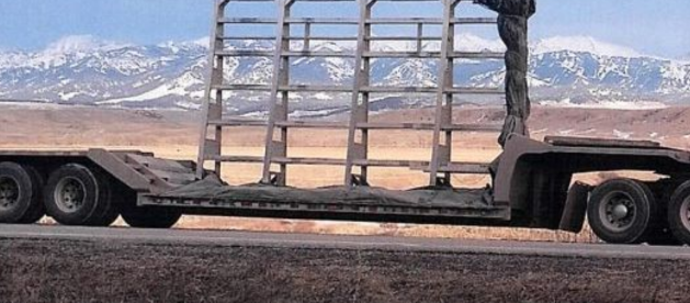

    If it were a former glass hauler, it would look like this, (minus the A-frame, but most glass doubles have raised frame rails off the deck that the A-frame mounts to)
    Rugerfan and OldRed98 Thank this.

    This trailer doesn’t have many tie down points at all. Which makes me wonder what it was used for.
    here is a picture of the deck up close. I noticed some broken glass on the trailer and wondered if that’s what it was used for

    That is kinda how glass trailer ratchet strap bottom securements look except the smaller bar hook locations on the frame are a little small. They may have had removable A-frames on there, but usually those are bolted down. It does look like there are chain pull-outs for chain binders along the edge.

    It had some sort off removeble structure fitted on a regular basis.
    4 u shaped pieces welded on the outside with a support under them.
