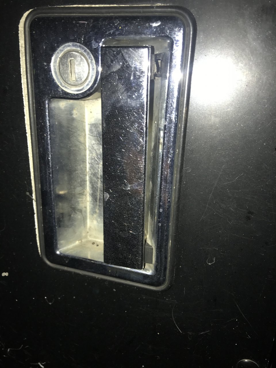

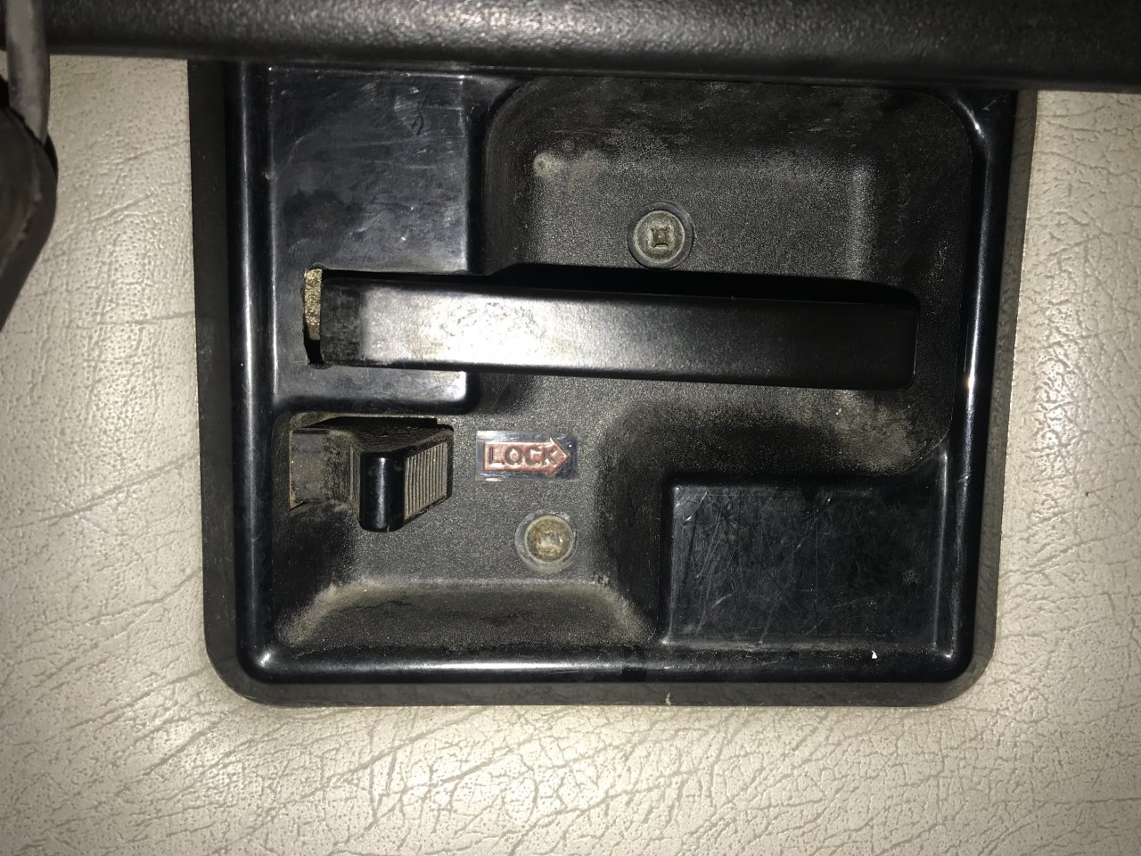

    1995 Pete - ICT sleeper, rear door handle finally broke. The guts are worn, whole setup needed replaced anyway.
    Does this look familiar to any known manufacturer?
    6BB839F3-62DE-4C8E-A484-1A018E4397A8.jpeg B0A09ADC-2CEA-4C6D-9674-D6140DEA558F.jpeg
    I’ll get pictures of the innards when I get home and peel off the door skin.

    ...looks like older domectic car handle ...gmc chevy

    Looks like one I've seen in an older S-10

    I was just gonna say it looks like a 80s chevy picup
    I have an s10
    If I don’t forget I can take a pic

    Check with ARI. The do Ict repairs.

    Turns out it’s a Trimark brand. Office in IA. Answered the phone, helpful, parts in stock.
    I emailed photos, they’re certain on the interior and exterior door handles, just working on the rotator mechanism.
    Any rods are application specific, so we’ll see.

    Same. I think it looks like an 88-98 GM full-size truck.

    I bought a TRIMARK handle from a RV dealer 3 years ago,,,it had to be 30 years old. No plastic parts in the guts,,unlike trucking companies using plastic door handles NAVISTAR
