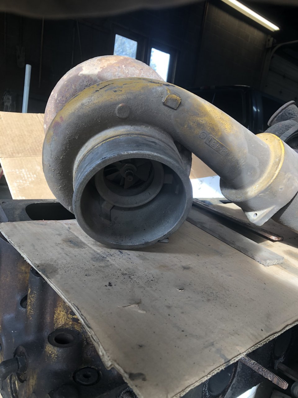

    Hello. I’m learning about these 3406B Cat engines that have been used in trucks over years.
    We have most trucks here that are powered by a Cat from the B’s to the C15 ACERT.
    The two we have, one is a 1987 Pete and the other is a 1990 International.
    The 1992 Pete uses a B model but has a different turbo being the only thing from the other two.
    Performance wise, the 1992 is the cleanest burning B model as it doesn’t smoke much.
    The 1987 and 1990 both perform well but always has a trail of smoke when the throttle is wide open.
    Measuring the opening of the compressor housing at the wheel, the 87 and 90 is a 76mm.
    The 92 looks physically larger but the wheel is smaller. 74 mm.
    The turbine opening is 90 mm for the 87 and 90.
    the 92 is 87mm.
    Over the years I’ve learned that large turbos have a harder time keeping the visible smoke down.
    We have a 92 B model turbo on the shelf and have been thinking of trying it on the 1990 international.
    The 1987 B model is our best performing Cat as it pulled harder than our 475 E model.
    If the newer model turbo cleans up the smoke better, the performance should be better too?
    This reminds me of the gen 1 dodge Cummins powered trucks.
    The early models have smaller compressor and turbine housings than the 1992-93 models which spooled better.
    The 93 Cummins we have is a slow spooling turbo that smoked a lot.
    I modified that turbo by changing out the turbine housing with a 97 model smaller size and that cleaned up all the smoke and increased performance without touching the fuel screws. (Still haven’t touched the screws to this day)

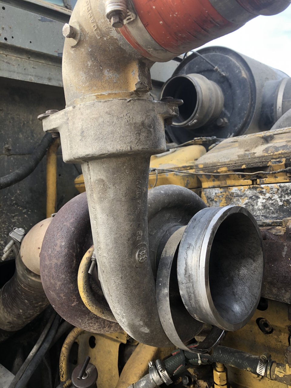

    this is similar to the 1992 Pete 3406B
    This is the International 3406B

    What are the power ratings of the different B models you have?
    Are those turbos the original P/Ns the engines were shipped with?

    AmodelCat:
    1990 International is a 425 hp
    1987 Pete is I think a 400 hp
    1992 Pete is a 425 hp
    We got these trucks from other people so I’m not sure if they’re original or have been replaced over time.
