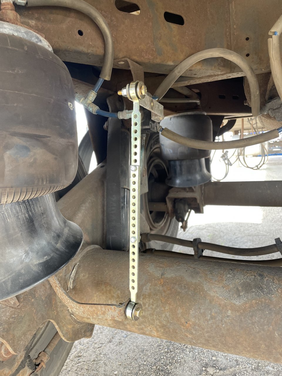

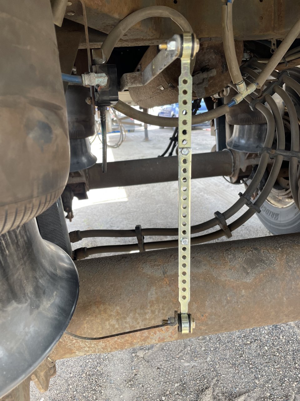

    Had to replace another/different rod with this 1, wasnt quite sure if I put the top and bottom parts on the correct sides. Pics attached

    It's attached correctly but it probably needs some adjustment. It looks like you have too much air in the bags the way they are now.

    Judging ftom those lines in the plastic base, I'd say your about 2" too high. Other than that, looks good

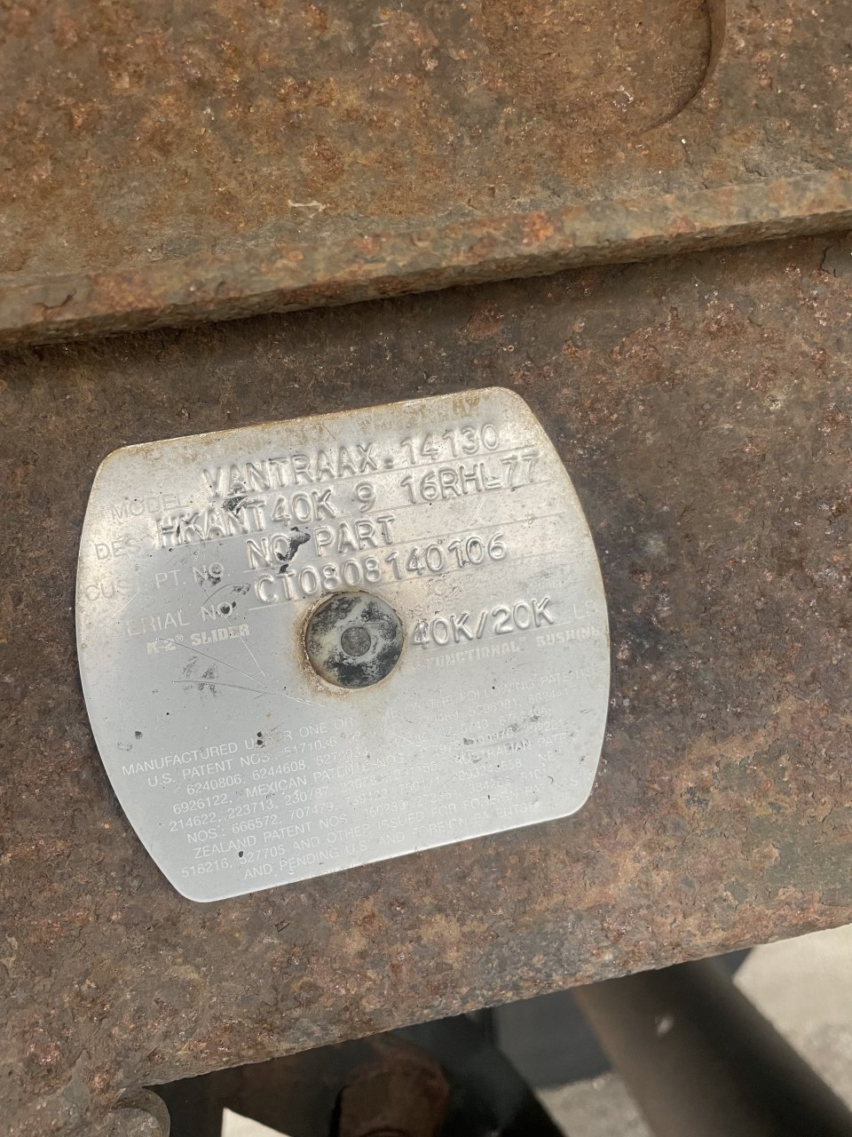

    Yea Im trying to figure that out next. Its a 2008 Utility and the sticker where it shows what the ride height should be is torn off. Its a Hendrickson suspension, attached the model # picture. Im guessing its supposed to be at the specific measurement from bottom of frame to top if axel?

    I need to lower it where the lines of the plastic base on the airbags is covered?
  7. Big Road Skateboard
    5,691
    29,651
    May 2, 2021
    Judging from the wear, yes. You can see the lines in the rubber have worn the same lines into the plastic base. That is where it normally has ridden. Doesn't mean it was correct before, but it looks pretty close to where it should be.

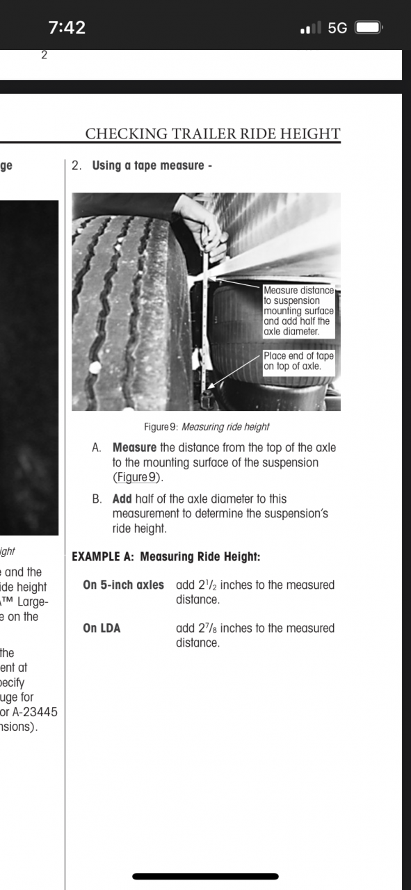

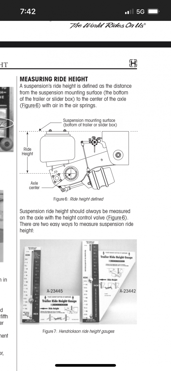

    This is what I found on their site, and what my trailer model is, so Im guessing 16” from top of axle to bottom of trailer? Im confused

    The procedure is on the Hendrickson site, but it won’t let me link to it.
    Basically measure top of bag closest to leveling valve to the axle, then add half the diameter of the axle.
