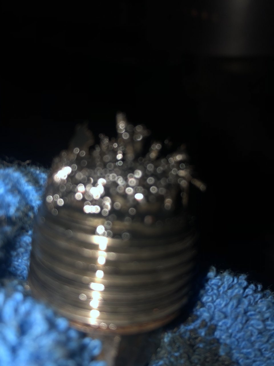

    7CE58448-9BA0-4421-8AF6-2D8C6186E55B.jpeg Drive it hard, making it work (Lug) a bit. Between 1350-1500. I’ve been doing that, and then occasionally running it up to 1700. I’ve ran it all the way up to 2100 quite a few times. If it’s ever coming apart, let it happen now. Lol. The harder the better, without tearing up the driveline. Lol. I just set the cruise, mostly, but been gassing on up hills, making it work hard. For now anyways. Opposite of my normal habits. It’s true, has something to do with side force of rings on cylinders. Lower RPMs are better at that. You want them seated up good, wearing into the sleeves, to get a good match in diameter. Opposite of just idling, or babying it. That will encourage glazing of cylinders, and increase blow by. Ideally more heat the better, within reason ofcourse. Don’t want to overheat it, or run over 1000 pyro egt. But definately run it hard. Temporary economy loss will payoff in increases in long run and less blow by, if broken in right. Should change oil soon, before 4K, to get all the metal shavings out, if any. I’ve read as soon as 2k, I waited till 6k. Too long. I changed it again at 16k. No more shavings. All 6 counterbores were cut, block cleaned good. Saw it with my own eyes. Even ran a magnet down each bore, and around the bottom. Still, here’s what I found on first oil change. YIKES!!! It’s normal.
