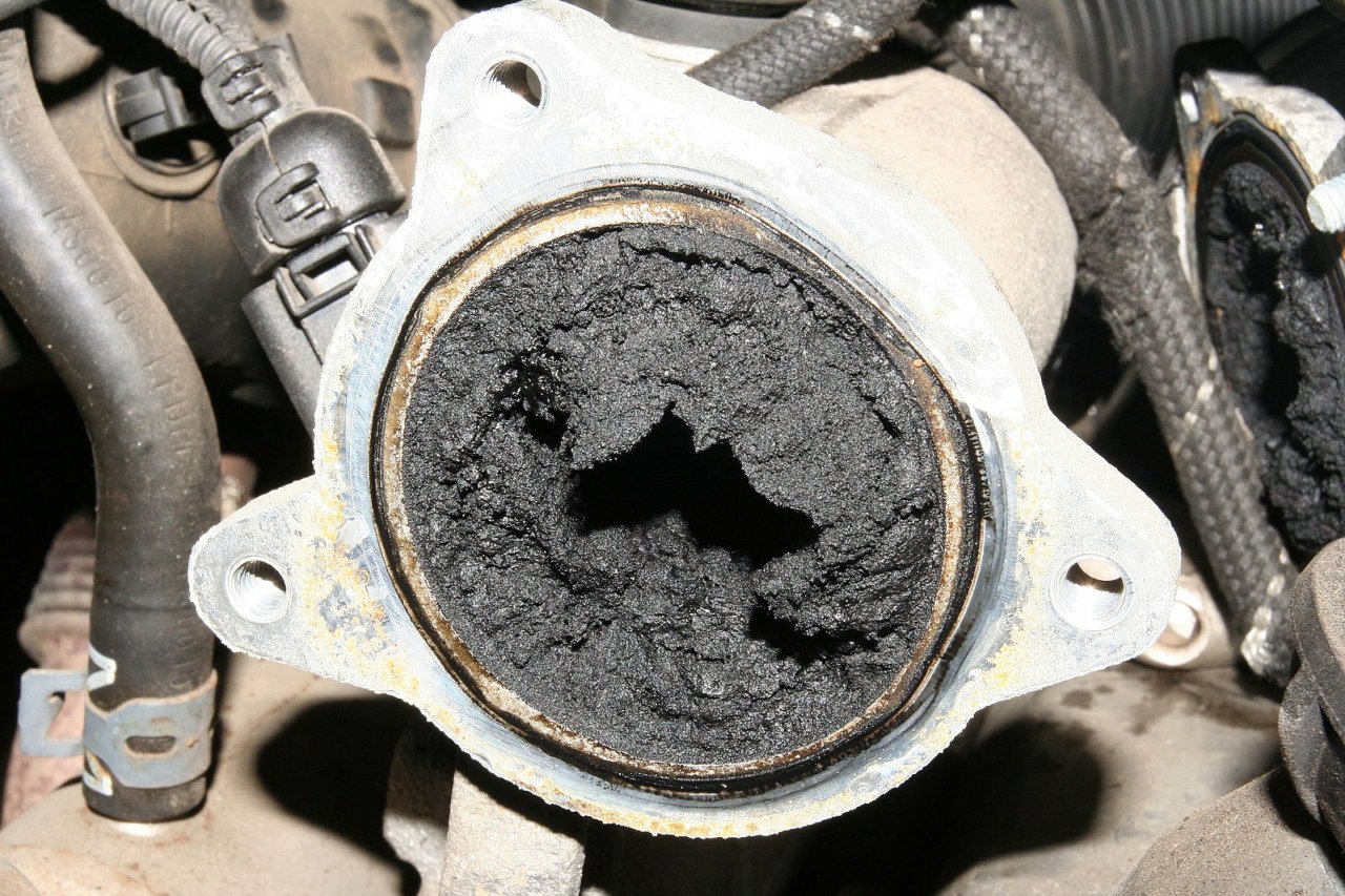

    If its not that then we start getting into more extensive stuff. Grey smoke is USUALLY a sign soot is going someplace it should not or that something is clogged. I cant go into details of why due to forum rules on deletes and this being about as much as i can give without risking a strike. But i can say if you DONT have an egr and a block plate odds are good you got a low end mod and your going to want to start pulling and cleaning all the emissions pipes as they likely look like this.
    And eventually soot backs up where it should not go. Even on fully function systems its generally a good idea to pull and clean those pipes occasionally. If you do it yourself i recomend CRC and making sure you get every vestige off at the end. Typically i spray the #### out of them with CRC then dump them in a bucket of water with dawn for an hour and scrub them hard with a pipe brush then hit em with a power washer before i hand dry as best i can and ensure no soap residue remains. Then bake them in the oven at 100-110 degrees for an hour to make sure they are as dry as they are going to get.

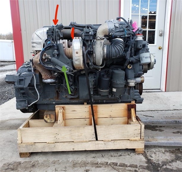

    Between the red arrow and the vertical red line was removed when it was deleted so I’m not sure if that’s where the EGR was. Also, right where the red arrow points is just an open pipe but there is a block plate clamped where the red vertical line is I drew.
    On a side question though, what is that object that the green arrow is pointing at? The end of the cylinder where the rod comes in and out has been disconnected and being that I was under the assumption that the flapper valve that cylinder was attached to might’ve been closing, my mechanic put a little tack weld on the lever to make sure whatever that is doesn’t try to close.

    Yup the red arrows WAS a EGR, looks like the entire assembly was removed. Pull all those pipes and check em. Ill bet ya dinner they are pretty #### clogged and/or that plate is cracked.
    As for the green arrow, Ill be honest i have no clue whats going on there. Mine looks entirely diffrent.
    Sorry for stock photo im sitting inside waiting on a shower and its a bit of a hike back out to my rig. Mine is totally diffrent and i have zero clue what they did. That said ill bet it was the controls to the EGR just based on where it all is.

    That cylinder is for the turbo BPV. Back pressure valve.

    So what does that do and being that all that California emissions crap’s been deleted, is that why the shop that deleted it disconnected that cylinder? Should it be reattached? I’m not sure if it was necessary to have my mechanic tack-weld that flapper open but when I started driving the truck, the shop that deleted it had a piece of what looked like clothes hanger wire wrapped around it to keep it from closing.
    One day at the fuel pumps I had the hood pulled back and was looking at all that stuff and noticed they didn’t tie it very well and I was able to move the lever by hand which kinda acted like an exhaust brake.
